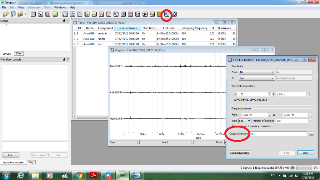

saeedsoltani
Joined: Sun Sep 01, 2013 9:34 am
Re: geopsytfa and geopsy are separate or they are integated together in geopsy?
Postby saeedsoltani » Fri Jul 15, 2016 12:24 pm
hi sivaram
I think you downloaded the wrong version, do you have the plugin that i mentioned with red circle in attachment?
when you use the hvtfa plugin you have a .max file in output directory that you will open it by max2curve plugin.
the max2curve output (tab:action --> save ) is suitable for inversion in dinver
(204.76 KiB) Not downloaded yet
