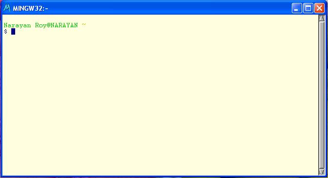

I have installed MSYS..IT is opening like the page that i have attached with this post..I am not being able to go ahed..How to proceed next???

Just type your commands. This is shell programming. There are a lot of books about it and you can find a lot of information with your favorite search engine.

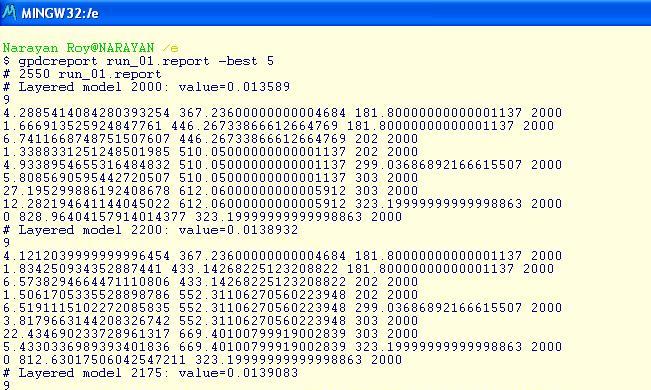

I have got the result..sir, i want to know what "9" indicating (in attachment)?? is it showing parameters at 9 different depths.. I think
1st column - Depths
2nd column- p-wave velocity
3rd column-s-wave velocity
4th column- Density
Am i right??? I am little bit confused..about the format of result..how can i reduce the digit after fraction?? One thing i want to know that how can i copy the model parameters into a text files???

1st column - Depths
4th column- Density
Am i right???
Yes, you're right
The first line indicates the number of layers including the half-space. More details about the format is provided by
gpdc -h all
To reduce the number of digits you can use awk utility like this:
gpdcreportrun_01.report -best 5 | awk '
/^#/{print}
  if(NF>1) {
    for(i=1;i<=NF;i++) printf("%.2f ", $i);
    printf("\n")
  } else {
    print
To export all output to a text file, you can use redirections ('>'):
gpdcreportrun_01.report -best 5 > toto.txt

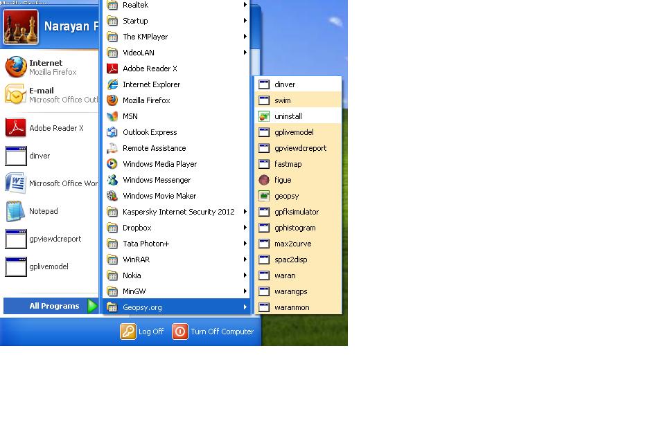

Another problem i am facing..I have installed full geopsy software..I am not getting gpdc tool...I need this tool for forward computation...Only some limited tool is available...I have attached a screen shot of the tools available...

gpdc is not a graphic tool. All the available tools are located in C:\Program Files\Geopsy.org\bin (under Windows if you select the default path for installation). The command line tools can be run from a MS-DOS console or better from MSYS. Linux and Mac OS X can run them from any terminal.
The PATH variable must be properly set up as explained at viewtopic.php?t=50.
